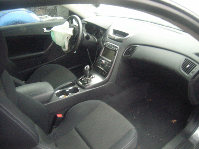

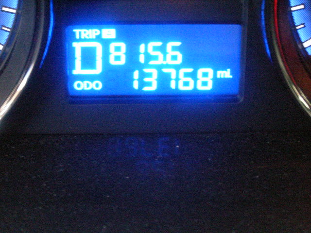

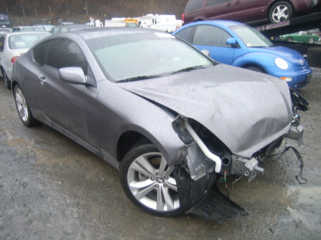

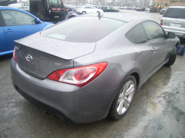

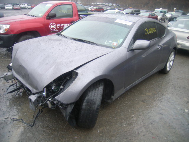

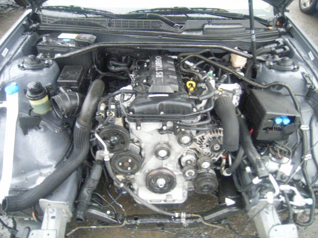

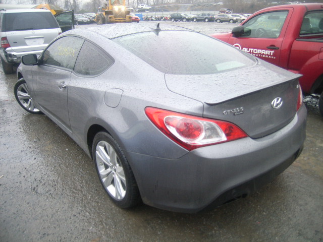

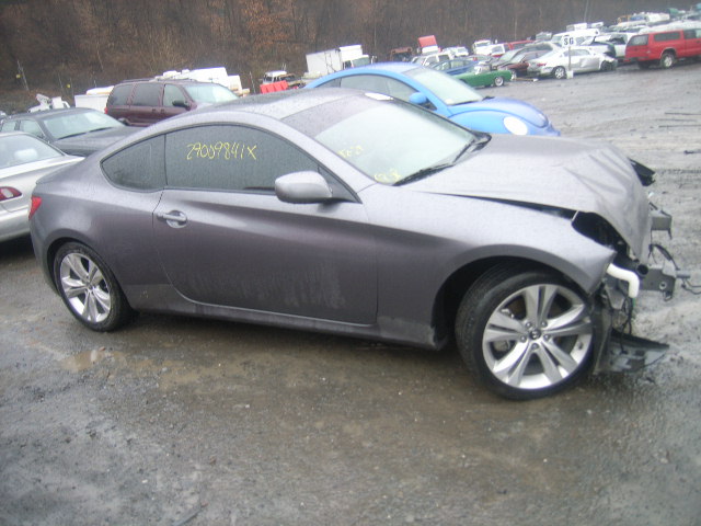

Hyundai Genesis Coupe z USA - proszę o rozkodowanie VINu. 2013/06/07 19:23 #44902
  • dax555
  • dax555 Avatar
Noooo tylko zderzak. :laugh: :P
Lot # 29009841
Actual Cash Value $23,670 USD
Repair Cost $23,236 USD
Title State NEW YORK
Title Type MV-907A SALVAGE CERTIFICATE
Odometer 13,768 ACTUAL
Primary Damage Front end
VIN KMHHT6KD0BU058971
Body Style COUPE
Color GRAY
Engine 2.0L 4
Drive Rear-wheel drive
Cylinders 4
Fuel GAS
Keys YES
AutoCheck found 9 records for this 2011 Hyundai Genesis Coupe Base / Premium / R-Spec!
VIN: KMHHT6KD0BU058971 Engine: 2.0L I4 MPI
Style / Body: Coupe 2D Country of Assembly: South Korea
Auction Location Newburgh, NY
Sale Date Monday, February 20, 2012
Virtual Sale Starts 12:00 PM Eastern Time (GMT-05)
Virtual Sale Item Lane D - Item # 4149
