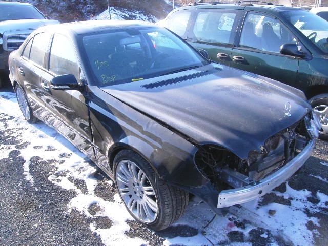

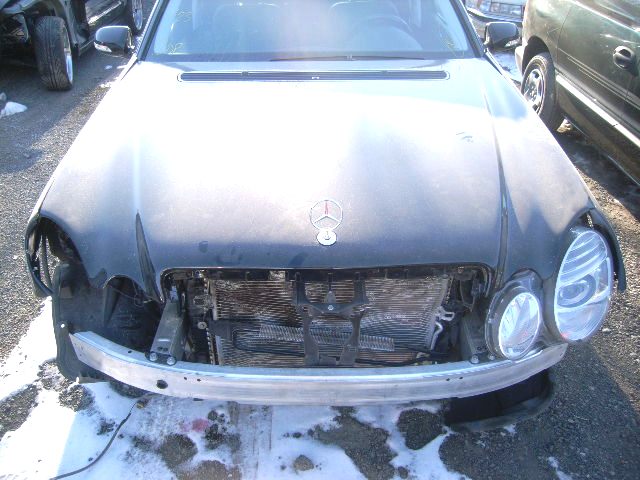

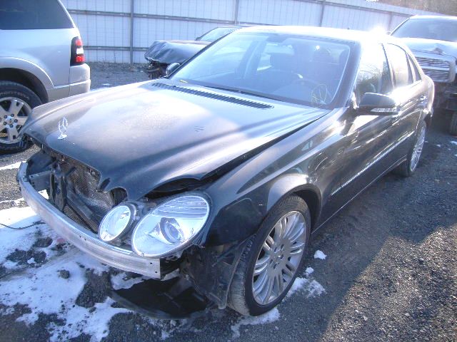

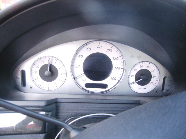

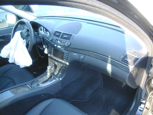

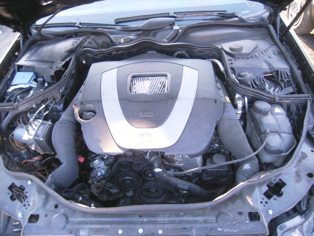

Przydałby się link do ogłoszenia.
2007 MERCEDES BENZ E3504M AWD 3.5L 6 INSURANCE SALVAGE
Actual Cash Value $59,800 USD
Repair Cost $0 USD
Title State NEW YORK
Title Type MV-907A
SALVAGE CERTIFICATE
Odometer 0 NOT ACTUAL
Primary Damage Partial/incomplete repair
VIN WDBUF87X57B126255
Body Style SEDAN 4DR
Color BLACK
Engine 3.5L 6
Drive All wheel drive
Cylinders 6
Fuel GAS
Keys YES
