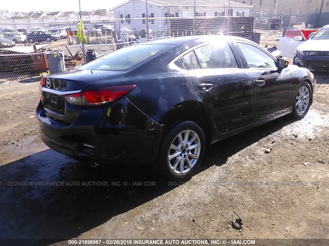

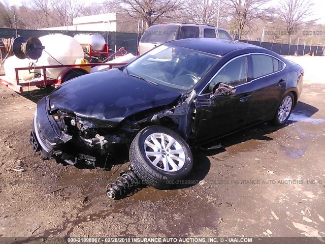

Wojtek ze stanow i bezwypadkowy jest szansa może pływał trochę,tam też nie rozdają samochdów za pól darmo.

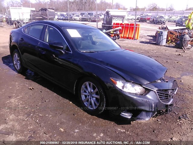

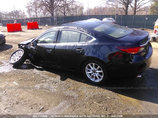

Prośba o sprawdzenie auta Mazda 6 III 2019/04/02 18:56 #86482
Date Mileage Source Details
2014-04-03 NHTSA Recalls Electrical System:alternator/Generator/Regulator
2014-10-27 NHTSA Recalls Tires:pressure Monitoring and Regulating Systems
2015 Original Manufacturer Shipped to Dealer - Original MSRP: $21,190
2015 Original Manufacturer Fuel Economy Test 25 MPG / 37 MPG
2015 Original Manufacturer Manufactured in Japan
2015-01-17 131,934 MD Historical Odometer Records
2017-06-22 NHTSA Recalls Parking Brake
2017-08-16 131,934 MD Historical Odometer Records
2018 36,000 miles Warranty: 36 Months
Type: Basic (expired)
2018-02-28 WESTCHESTER IL Junk And Salvage TO BE DETERMINED
Brander Name: IAA
Phone #: (708) 492-7000
2018-02-28 WESTCHESTER IL Junk And Salvage SOLD
Brander Name: IAA

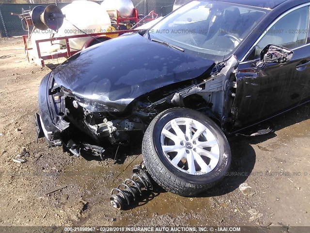

2018-03-05 BLOOMINGTON IL Total Loss
Brander Name: STATE FARM (R) AFFILIATE
Phone #: (855) 231-1590

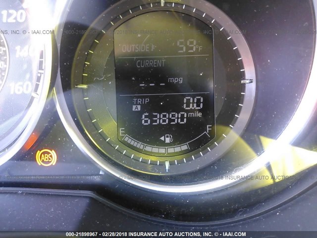

2018-03-20 63,890 MD Historical Odometer Records
2018-03-20 MARYLAND 63 Point Title Check
Salvage: Damage or Not Specified
2018-04-13 63,890 mi (Actual) 7131 Virginia Manor Court, Laurel, MD 20707-6506 Salvage Auction:
Primary Damage: Left Front
Secondary Damage: Front End
2020 60,000 miles Warranty: 60 Months
Type: Powertrain
2020 unlimited miles Warranty: 60 Months
Type: Rust

Prośba o sprawdzenie auta Mazda 6 III 2019/04/02 19:21 #86483
  • Fifi1503
  • Fifi1503 Avatar
Słabo to wygląda. Dziękuję za pomoc!!! :)
